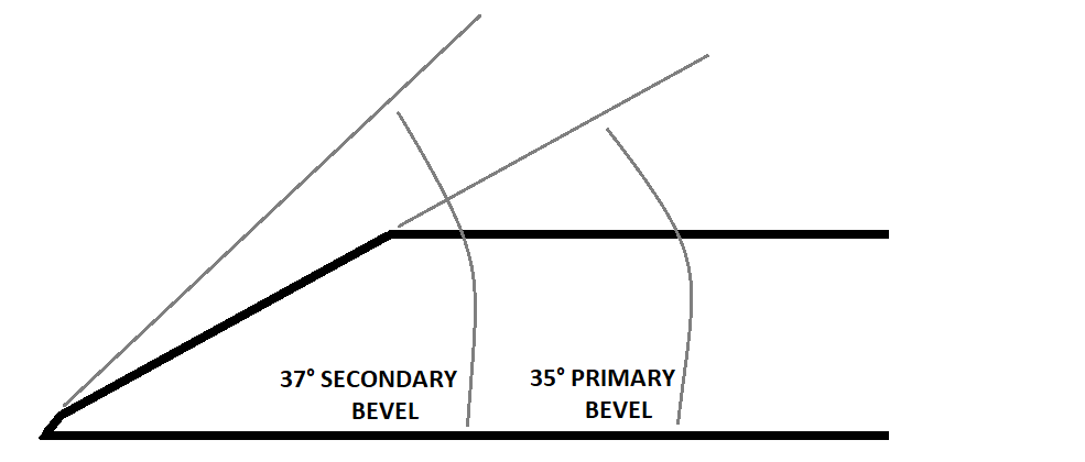

Planer and jointer knives typically feature a double bevel cutting edge. The standard configuration for most knives is:
- Primary bevel: 35°
- Secondary bevel: 37°
This design provides a sharp edge for general woodworking. For example, the Grizzly G6701 knife set uses this standard configuration.

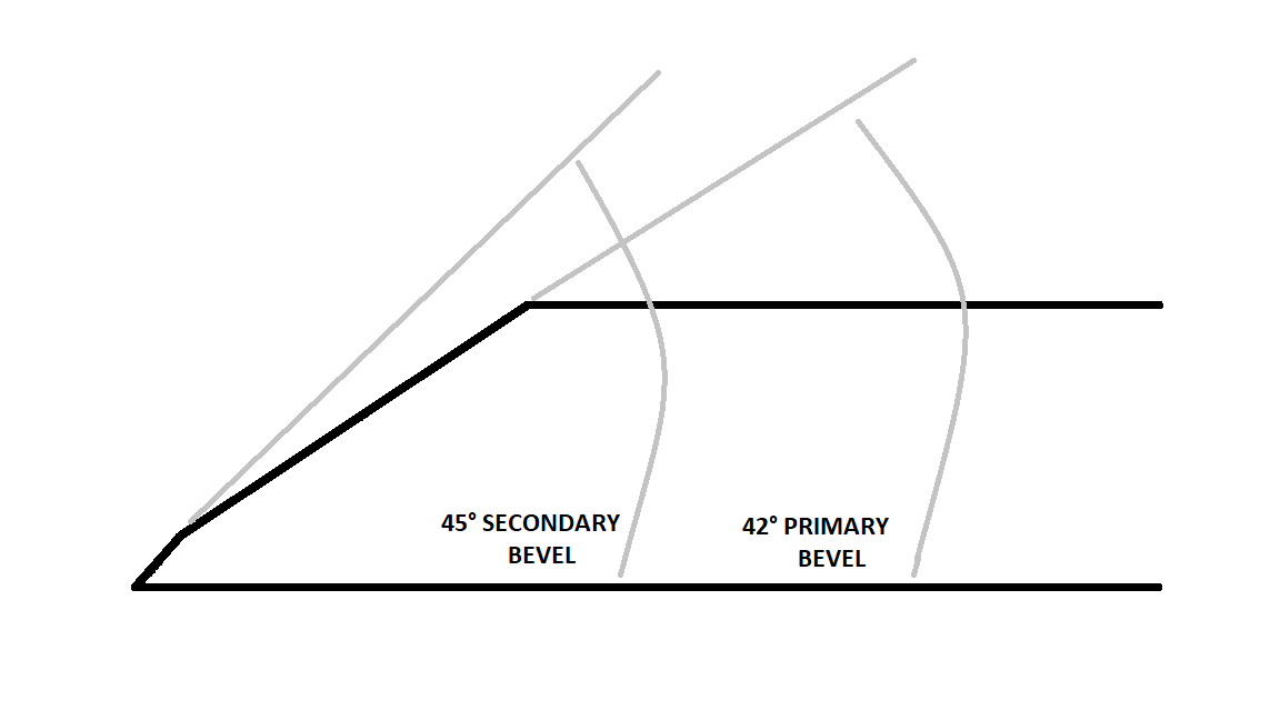

For hardwoods, a common configuration is:
- Primary bevel: 42°
- Secondary bevel: 45°
This design is used in premium blades such as the Japanese steel blade set T10152. Example:
