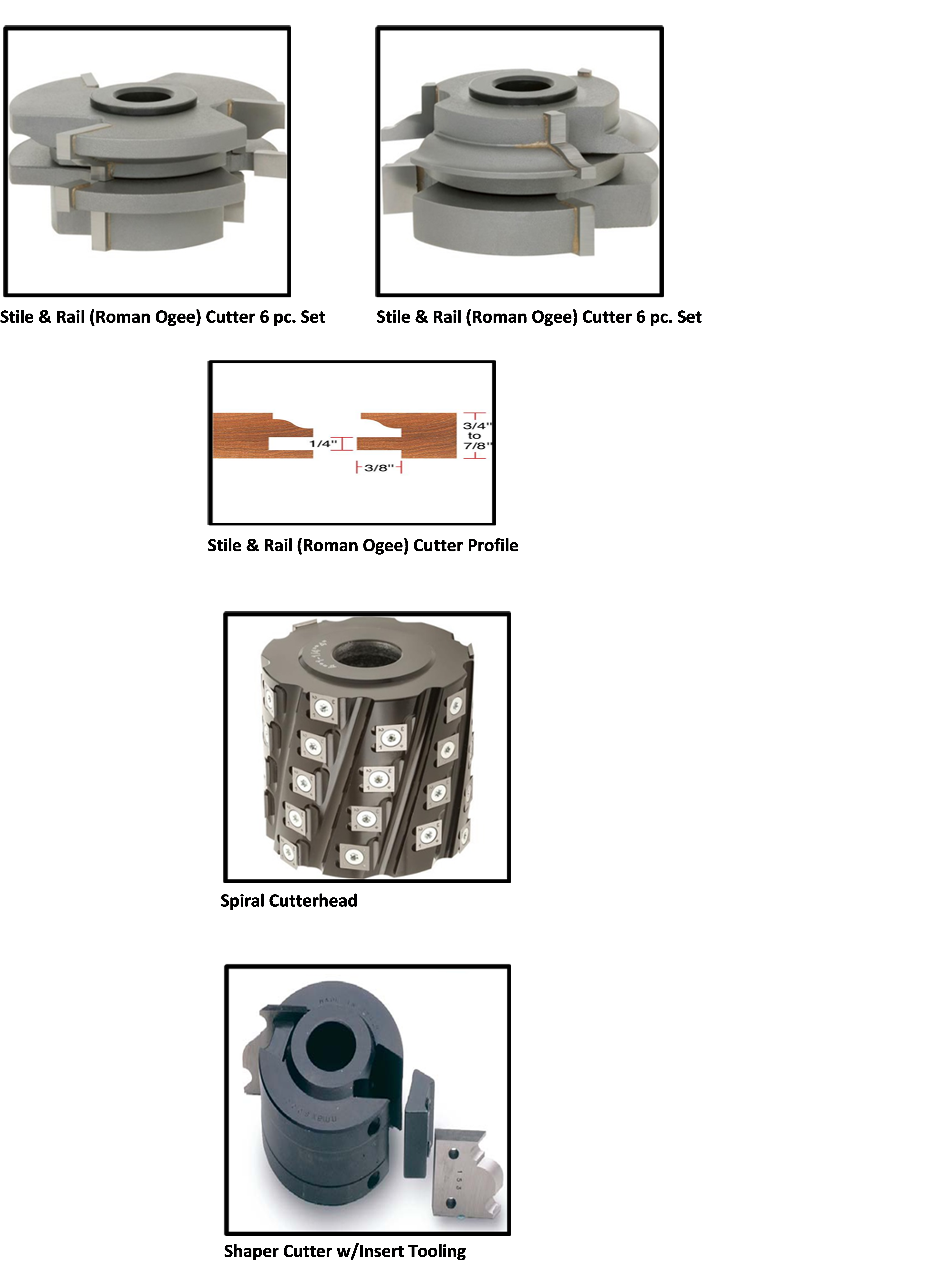

Two Types of Shaper Cutters
There are two primary types of shaper cutters:
- Solid Carbide-Tipped Cutters
- Have carbide cutting edges permanently brazed to a solid steel body
- Durable and effective for high-volume shaping
- Available in a wide range of profiles
- Insert Tooling (Replaceable Knives)
- Feature steel or aluminum cutterheads with replaceable carbide insert knives
- Ideal for production environments where quick knife changes are needed
- Cost-effective in the long run due to reusability
Both types are available in standard spindle bore sizes:
- 1/2"
- 3/4"
- 1"
- 1-1/4"

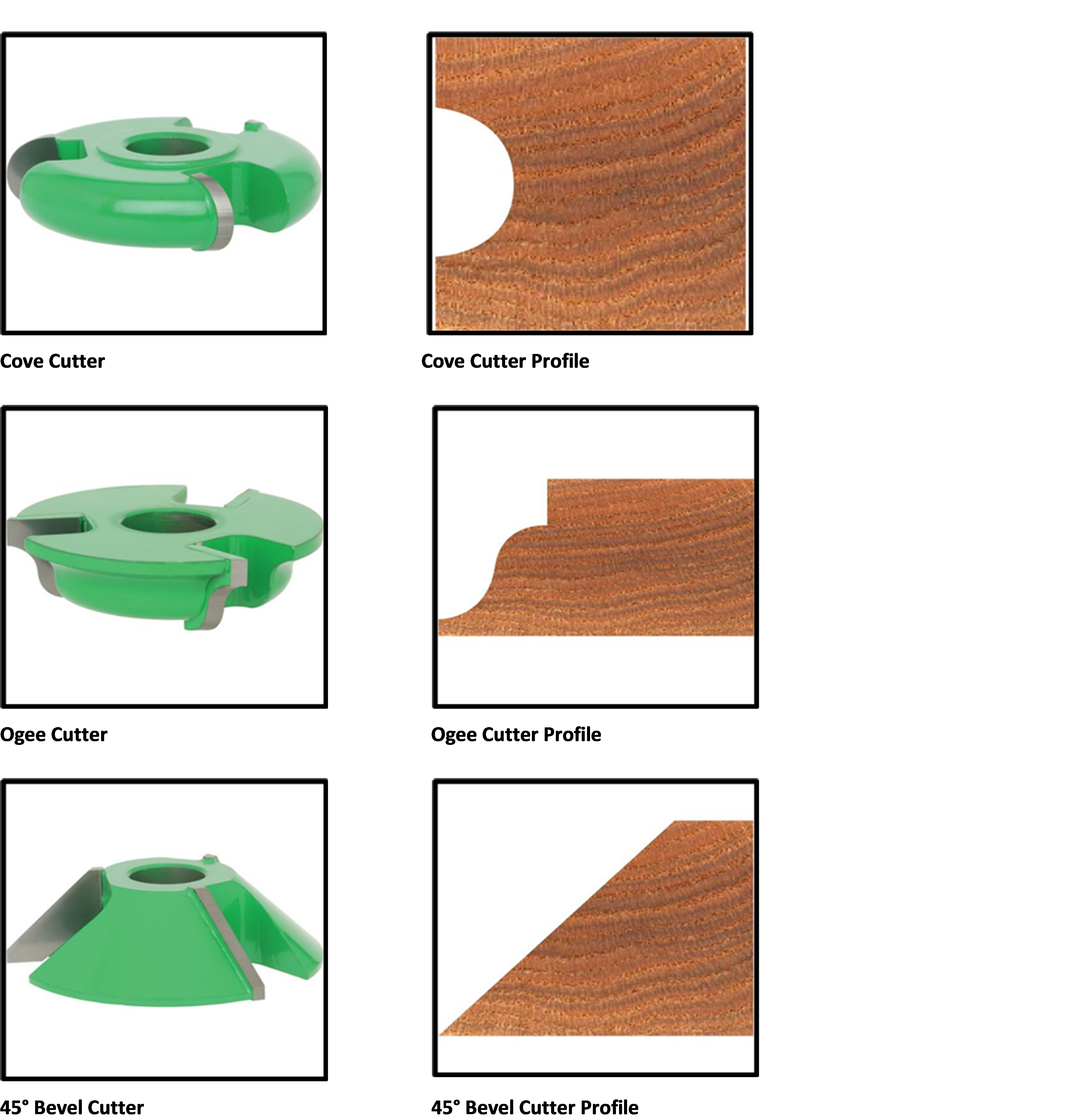

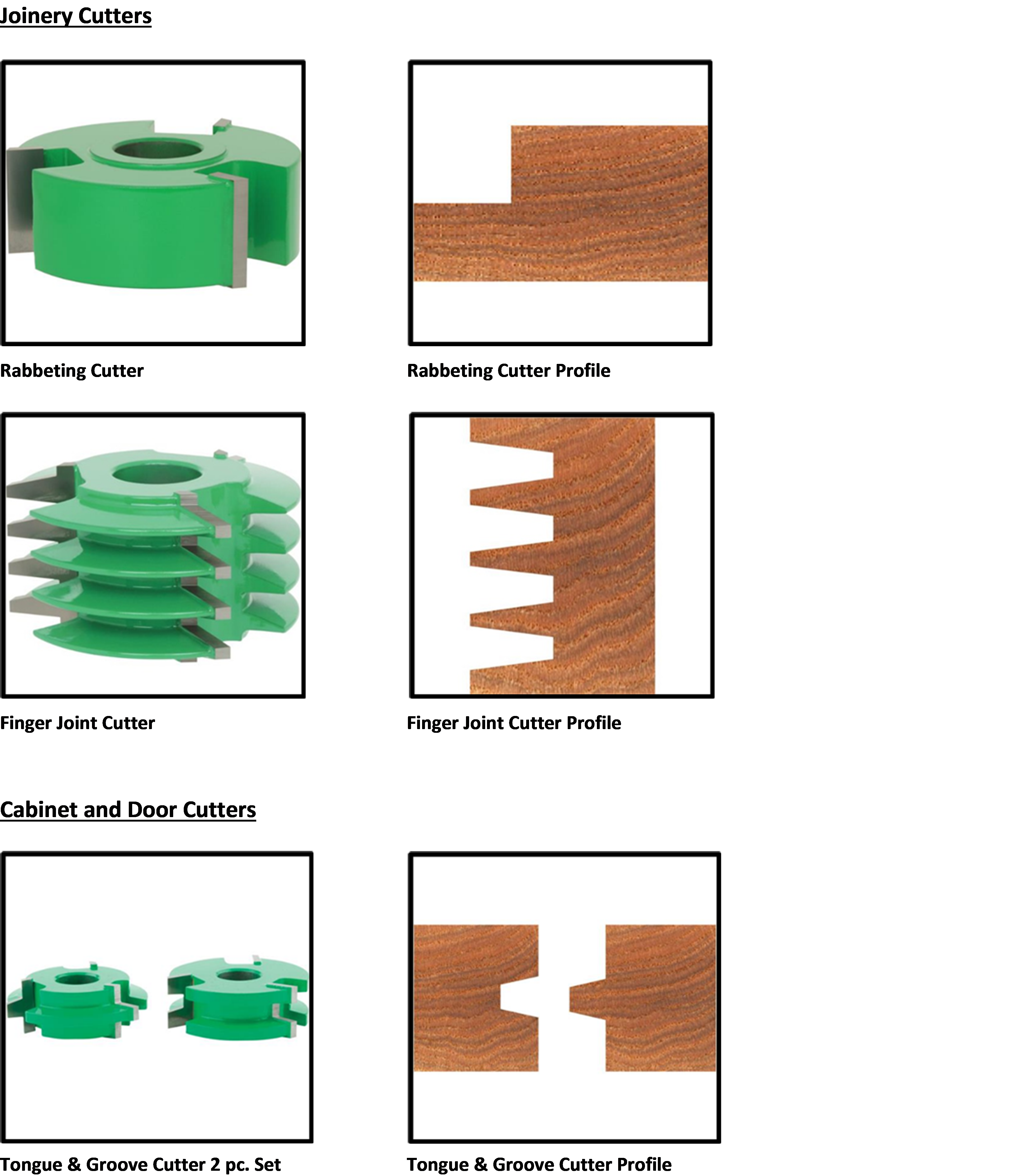

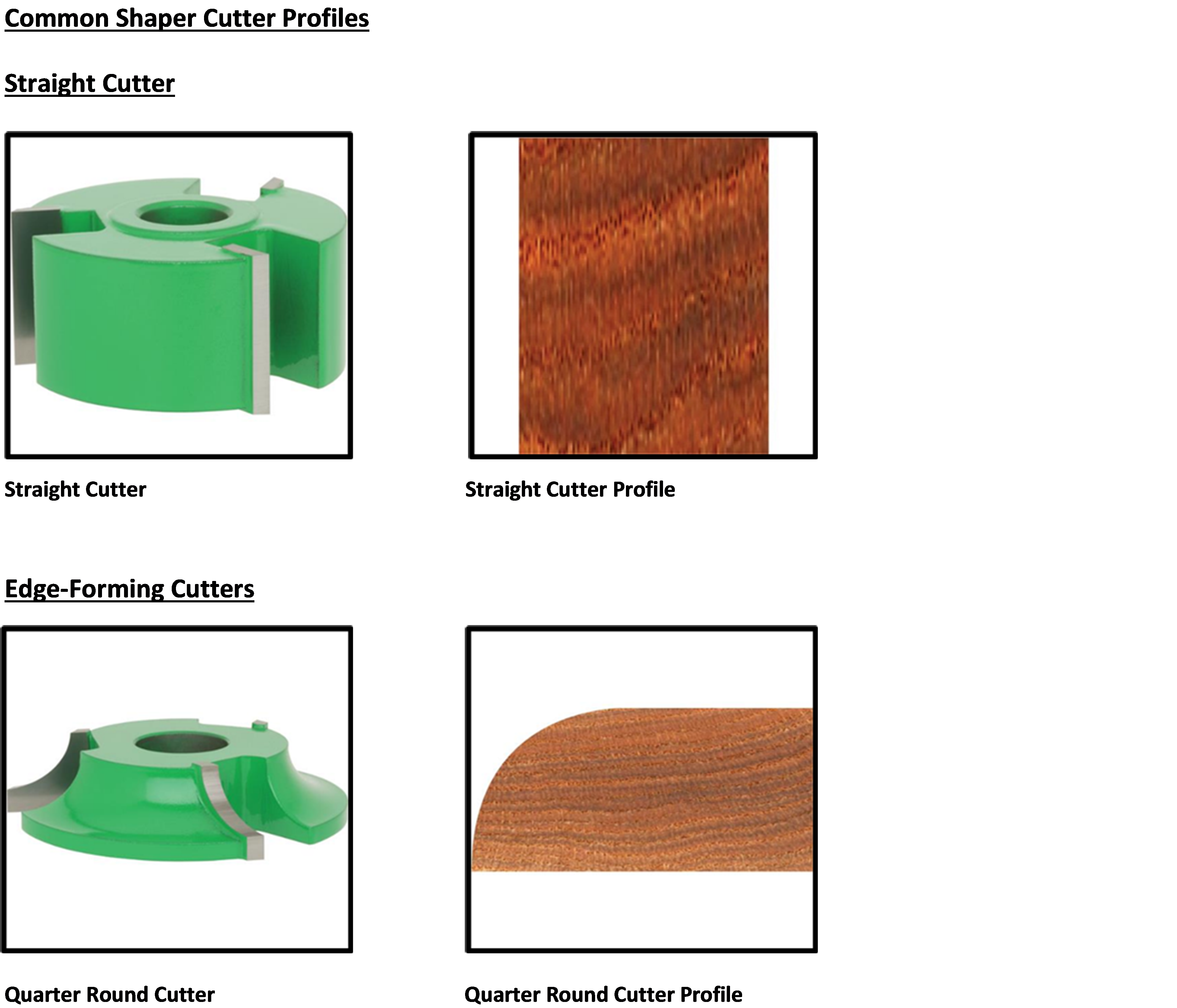

Common Shaper Cutter Profiles
Shaper cutters come in a wide variety of profiles for different applications:
- Moulding cutters
- Flush-cutting
- Panel-raising
- Cope-and-stick sets for cabinet doors
- Glue joint cutters
- Miter-lock, tongue-and-groove, and finger joint cutters for strong joinery
