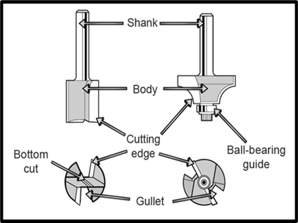

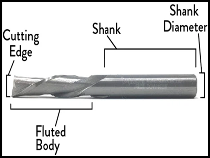

Router Bit Components
Shank – 1/4" or 1/2" solid shaft portion of the router bit installed into the router’s collet and secured with a collet nut.
Shank Diameter – Shank diameter is the width of the router bit shaft. This is an important measurement to determine the proper cutting speed, suitable cutting depth, and whether the bit is the appropriate size for the router.
Body – Contains the cutter or cutters that shape or cut the workpiece.
Cutting Edge – Removes material from the workpiece.
Fluted Body – Consists of the cutting edges, and grooves/gullets milled into the router bit body. The flutes are responsible for evacuating chips and debris from the workpiece.
Finish – Teflon coating (PTFE), paint, or powder coating used by some manufacturers to reduce friction, pitch build-up, and to help event rust.
Ball-Bearing Guide (Pilot) – Used on flush-trim and pattern bits as a guide to rout one surface flush with an adjoining surface.
